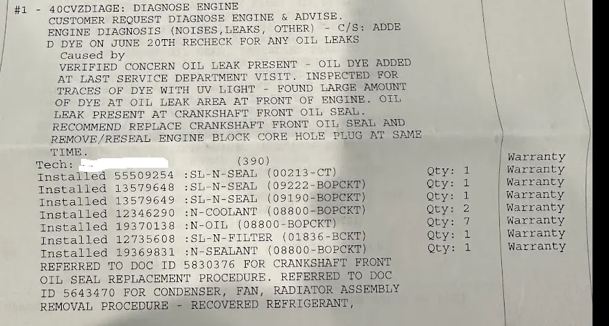

Update. I got the truck back on Monday evening like they promised. I'm attaching the tech's notes and what all was involved.
Glad warranty covered it. 6.4hrs, not an easy job.
