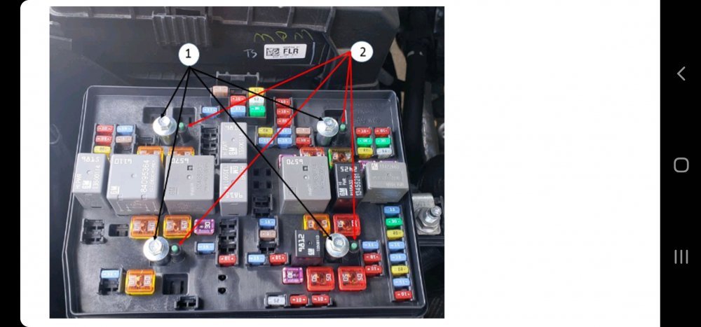

Anyone have a diagram or location drawing of the grounds that need checked ??
I have not heard of any problems with the grounding system.
There is a TSB on the bolts for the underhood fuse panel.
My truck is not included in the tsb, but the bolts were loose.
