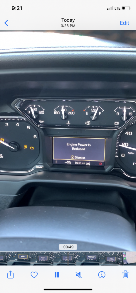

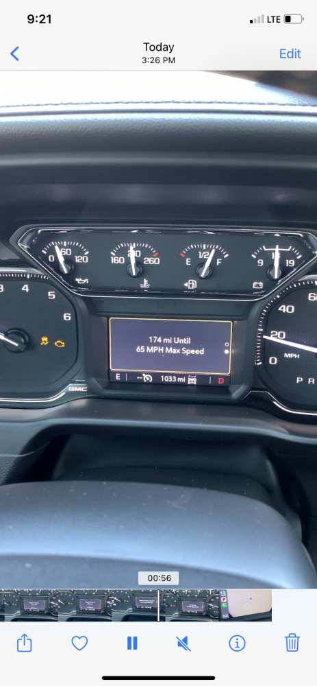

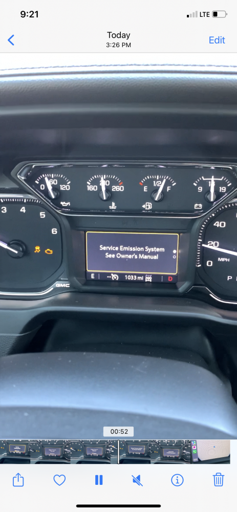

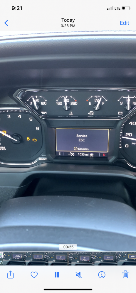

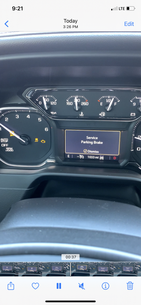

The next morning after getting it delivered, I ran some errands around town. After about 20-30 miles, it went into “reduced power mode” while driving. It would rotate through error messages saying “service ECS”, “service parking brake”, “service emissions system, see owners Manuel”. It also had check engine light on, parking brake light on, and I believe traction control light. I limped it into the dealer and they were able to see all of the error messages. They hooked it up to their computer and documented what codes it was showing (sorry I don’t know specifics). After having it back on their lift for a couple hours, they returned it to me saying they couldn’t replicate the problem and the codes have now cleared. The service advisor said he didn’t know what could have caused it and just said to drive it and hopefully it doesn’t happen again.. if it does, bring it back in.

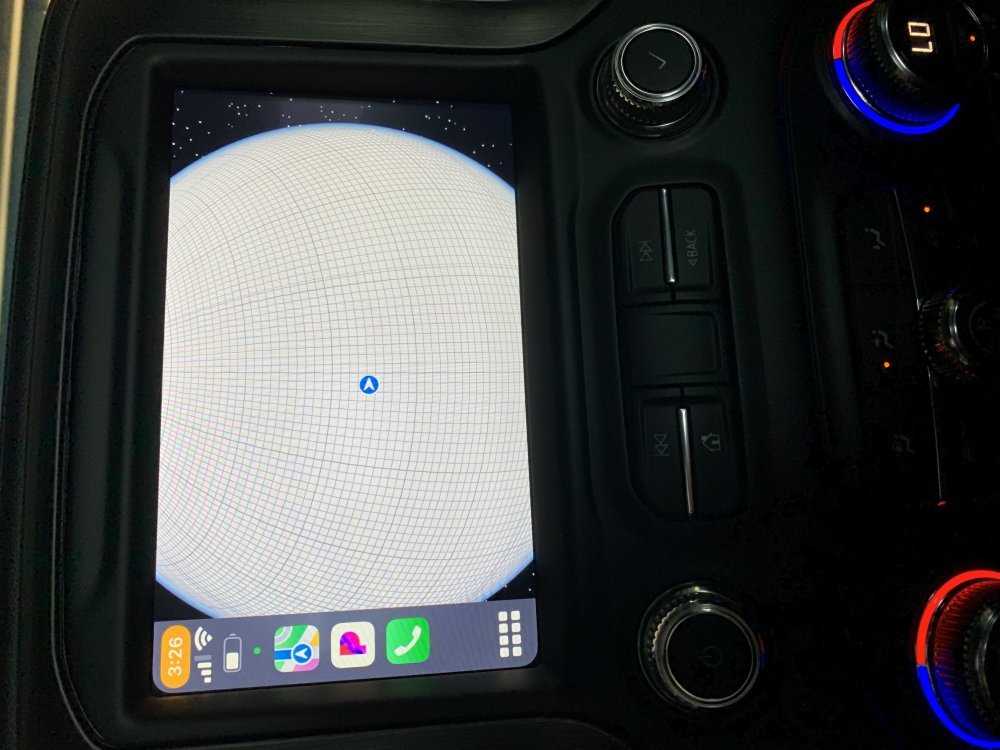

The truck drove good for about 4 weeks after that. No issues. Today, while driving on the freeway, slow and go traffic, the exact same thing happened again. This time there was pretty significant vibration from the front of the vehicle. The maps on my screen when blank, then came back on with what looked like a zoomed out map of earth and froze there for a few minutes before going back to normal.. all of the same error messages were showing. I called the dealership and they suggested I drive it there if able to.. I took some photos and video of the messages, and was able to get it over to the dealership in “reduced power mode” going about 20 mph. Any speed over that and the vibration would increase significantly. The truck now has 1,039 miles on it.

The dealership tried multiple fixes that didn’t resolve the issue and filed an inquiry with GM. They were instructed to replace the wiring harness. Just like the post above, the tech said it looked like there was possible heat damage to the wiring harness. It was in the dealership for about 26 days trying to figure it out and the entire harness was replaced.
First drive on the freeway once I got it back, the check engine light came on. I brought it back in and diagnostic test showed a code for the cadillic converter being bad.. the service manager told be it might of damaged it or a sensor when it misfired while in limp mode???? They ordered the new cadillic converter and I drove the truck in the mean time as they said it wouldn’t cause further damage. 2 weeks later the new cadillic converter came in and they replaced it in an afternoon.
I’ve put about 3k miles on it since then with no further issues. Hopefully everything is resolved
