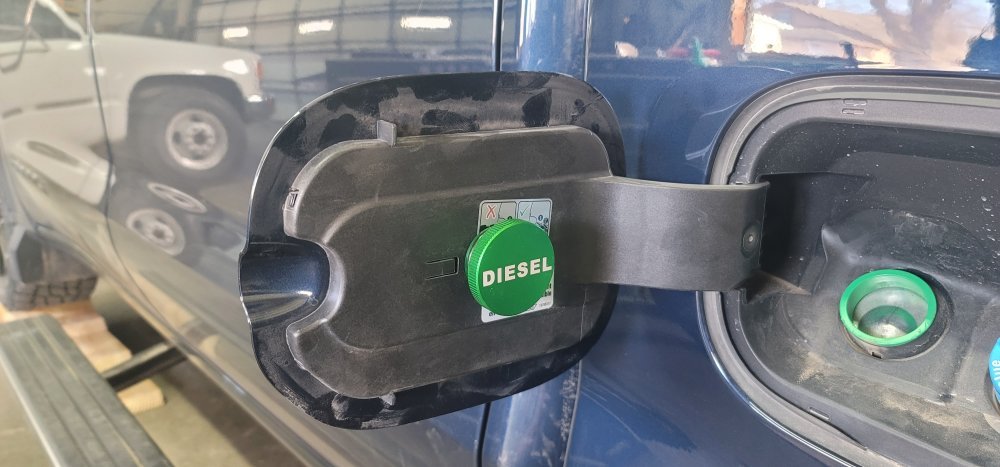

Been meaning to post this for awhile now...
For those of you that don't want to scratch your paint and can't find anything magnetic besides your painted box when fueling...

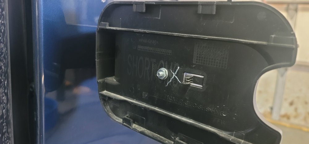

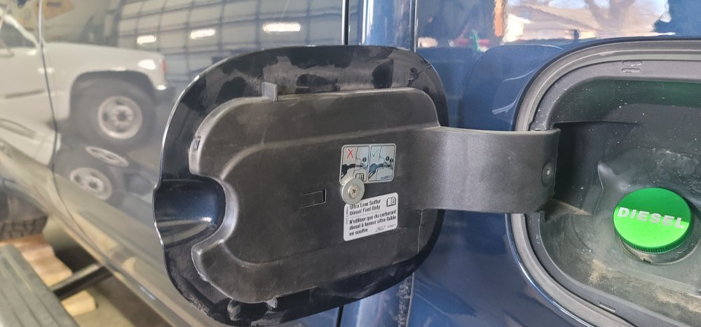

10-24x1/4" Phillips flathead machine screw and nut along with a 1/4" flat washer...
