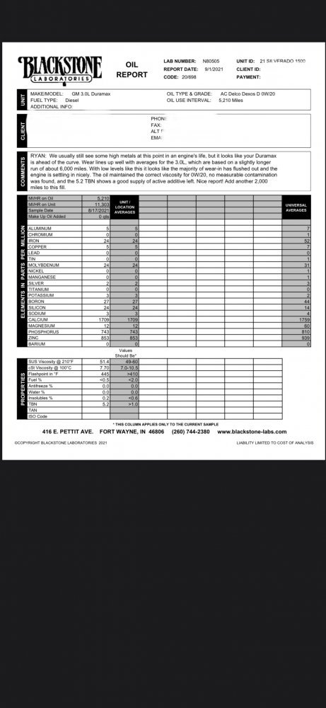

Just ordered 2 oil analysis sample kits. Been running DexosD GM oil 0W-20, gonna send a sample at the end of this week when I change it, should have approx 10,000 miles will be my 3rd oil change is a bit premature for sure but the first one I did at 1000 miles. So I will take a sample and send it out for analysis, also been using AC DELCO GOLD UPF66R ENGINE OIL filter
Then I will switch to the WIX WL10351, Its supposedly has 5 smaller micron rating approx, I also will switch to AMSOIL Synthetic Diesel Oil SAE 0W-20
and then send it out for another sample and see if any changes?
More to come with results
