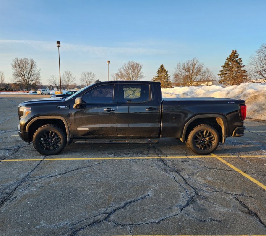

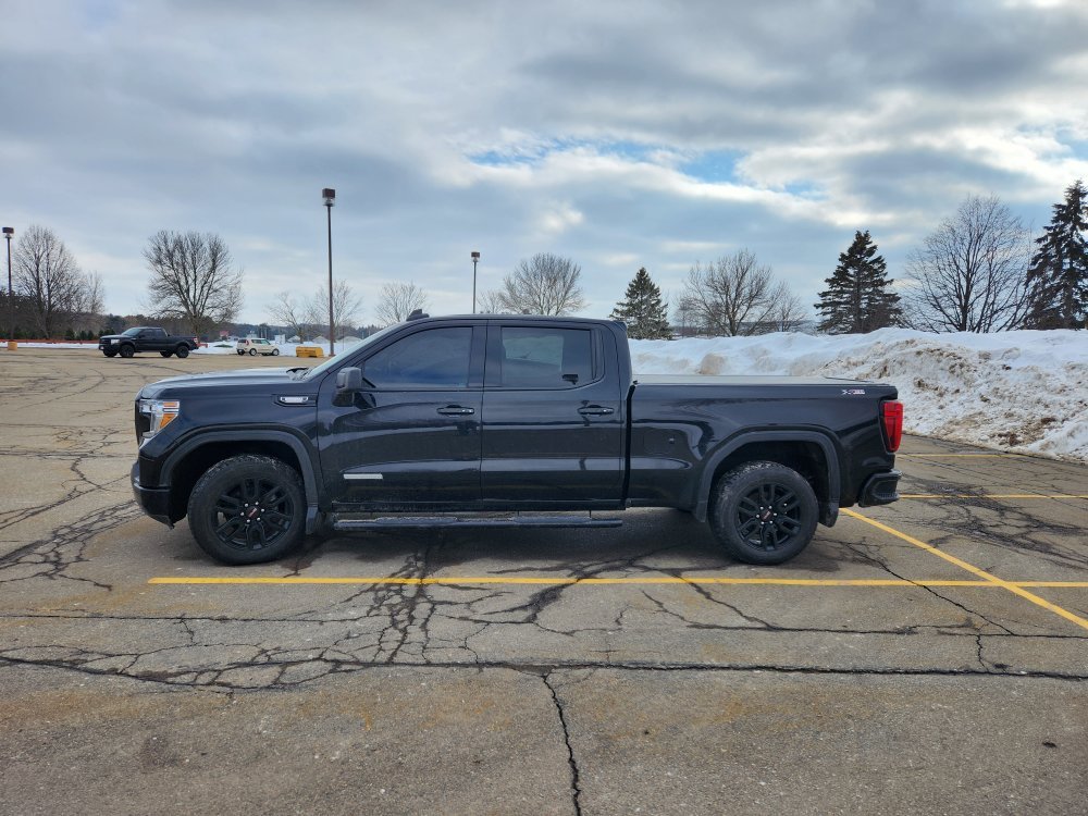

I would totally agree. The looks are 100% better and I prefer the ride better. Maybe not the best comparison but like comparing a Buick to a Pontiac. If you like the softness of a Buick, keep the Ranchos. If you prefer the sportier ride of a Pontiac, go get the Bilsteins. Neither are terribly bad, just a matter of preference. I'll try to attach some before and after pics. It was not washed at the time so ignore the dirtyness 😀. Won't let me add two so here is before.
