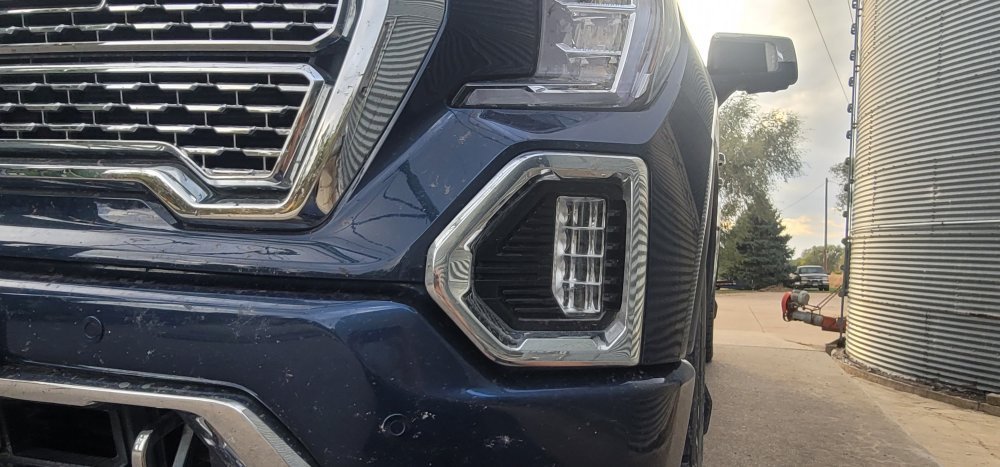

Can anyone tell me where the location to plug into the block heater. 2020 GMC

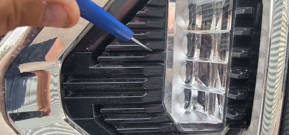

Gently pry up where pocket screwdriver is and it will pop out and hit the ground. Don't know how many times it can be removed in its life. Once removed for the season, I stash it in the rear seat backrest cubby. Along with the spare power cable, if'n I will be somewhere cross country, I will have a cord.

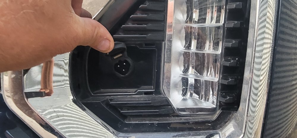

When you find it, it has a spring loaded cover for the pins. I just held it open for the picture.
