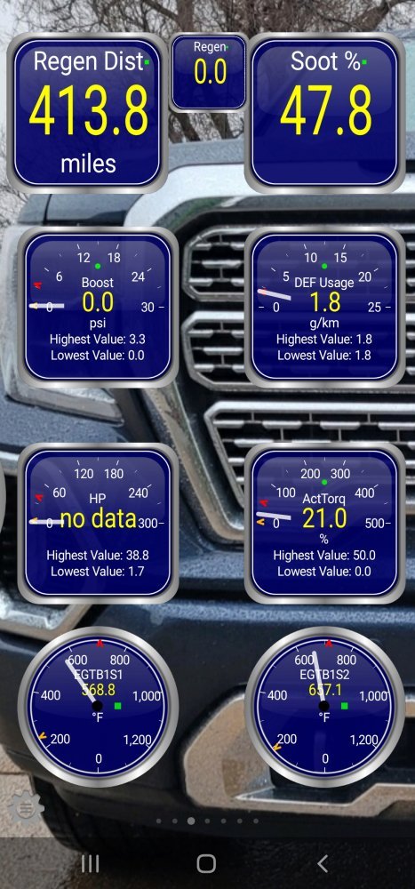

I am using torque pro and a OBDLink MX+.
Installed the GM specific pid's. I monitor regen, distance till next regen, exhaust Temps, def useage and soot level all on 1 screen. You can just swipe for different screens you make.
very nice but it brings up another question and i am sure everyone has an opinion the question is
What extra gauges do you find most useful? most useful when towing? thanks to everyone who post
Boost and exhaust temp.
