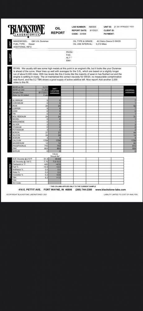

My oil changes have been almost identical to yours with mileage between changes and oils used. While my iron count is a bit lower, Blackstone acted as if it all looked good. Maybe the guy doing your sample didn’t see that you were breaking in a new engine?
They even said you could go another 2000 miles on your next fill so that says the oil is lasting well. Blackstone seems to have an actual personalized report while the other one more generic without actual insights of comparison to other 3.0L Duramax's.
