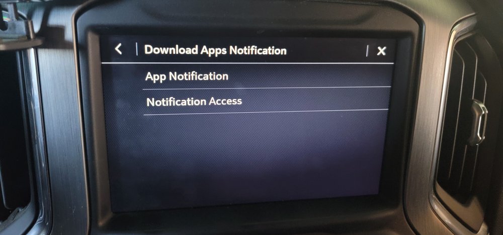

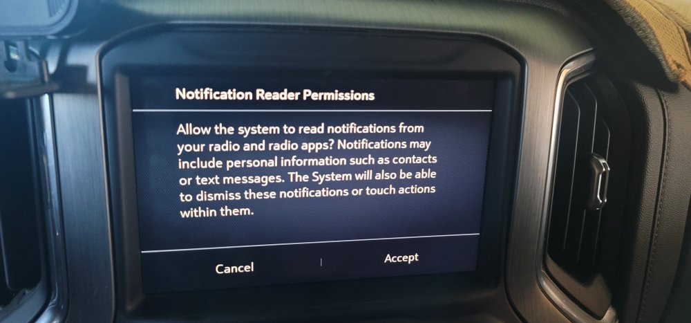

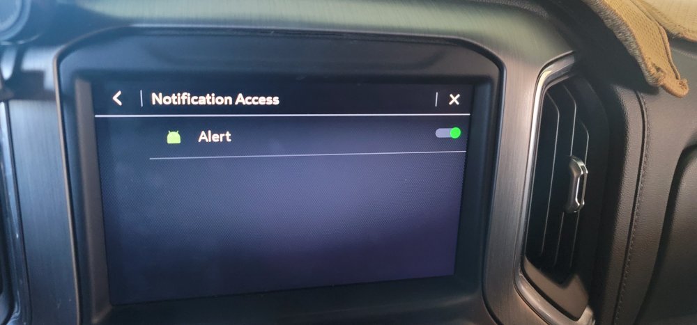

I thought I was all over the settings pages, but I don't remember the notification tab. I never had any notifications from my phone, when connected to my truck, so I would miss texts, weather alerts, etc. Got phone calls, but that is about it. I stopped connecting my phone.
Can someone here look at their settings and see if the information on the following pictures are present on v.155?
The notification toggle was off on mine. Maybe this isn't new and that was the reason I didn't hear notifications thru the truck.
Thanks in advance. 20210824_151507.jpg20210824_152758.jpg20210824_153611.jpg20210824_153558.jpg20210824_153550.jpg

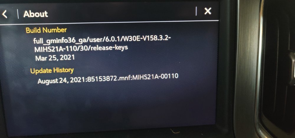

Just went to the truck and took a picture of the About tab, to make sure it "took" the update, even though it said it was successful. Truck is a 21, 10-22-20 Fort Wayne, USA build.

version updated toV158.3.2-MIHS21A-

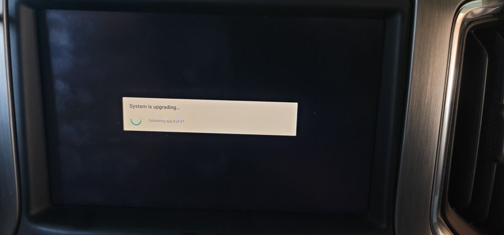

Amazing, the smaller flash drive worked well took about 35mins, started and all worked well, drove about 10 miles making sure all worked, shut down, and on restart screen came up said software download now complete.
