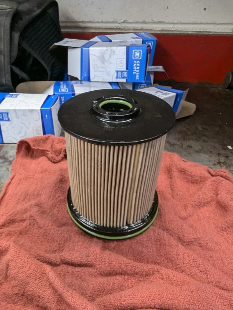

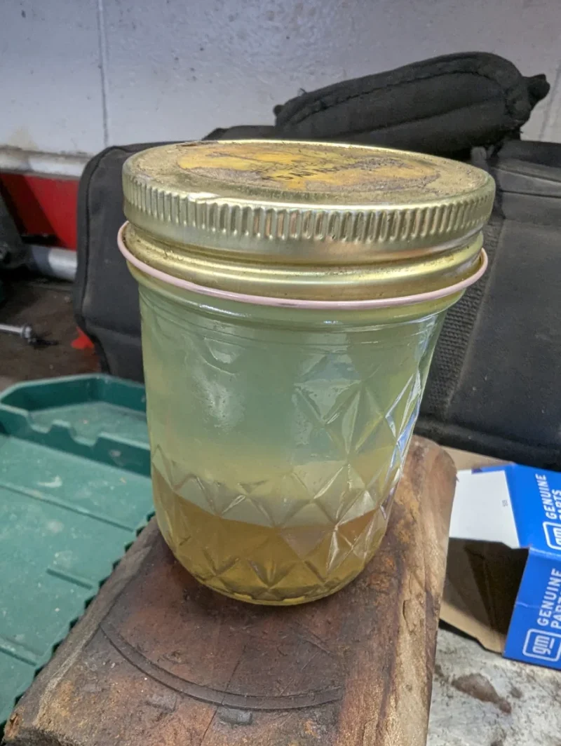

They showed me the sample in the dealership. This is it and the filter looked very clean.
