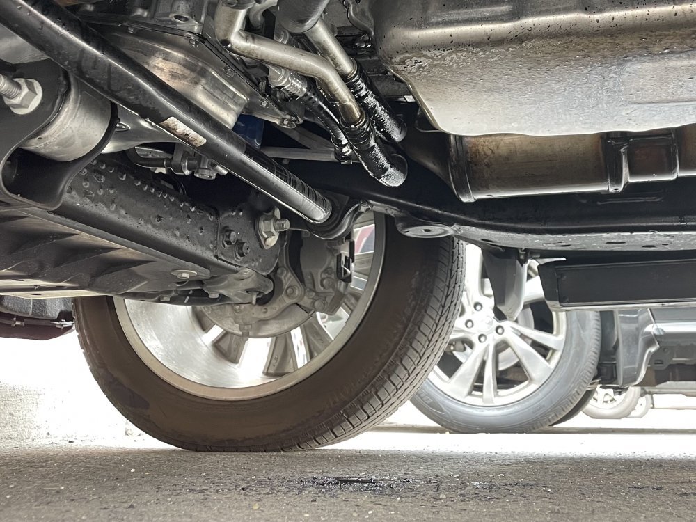

Have a 2020 1500 Diesel with 11k miles. Rear seal blew while on a road trip 250 miles from home, engine light came on steady, reduced engine capacity, trans fluid up to 195 degrees, oil down to 18%, leaked all over, undercarriage/running boards all splattered. Towed to dealer, should have it repaired in 4 days they needed to have the part FedEx'ed. Apparently they are going to have it delivered to me back home. We will see. Hope that is the last of the problems.
