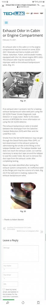

Noticed that I am getting Diesel odors while stopped in traffic or idle, very strong odor like kerosene. I have 9000 miles on it. Any ideas?
See attached information on exhaust odor in engine compartment or cabin. Something to look for.
I had the same odor. The dealership replaced my def tank with all the sensors, injector and heating element replaced under warranty. That cured it.
