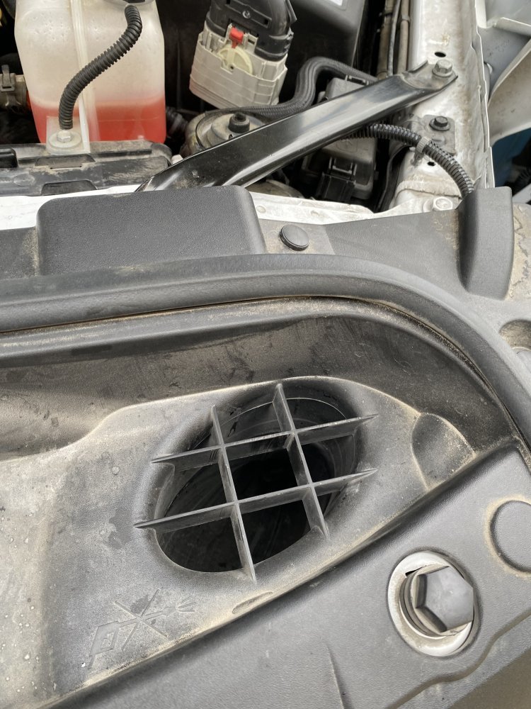

This is the only air duck I see in front of truck. Can’t tell if it’s open or not.

I believe it a combination of things, temp and speed. But the ecm at the end of the day. There is a plastic motor mounted on the left radiator support, that opens and closes the louvers, sorry, shutters.
If'n you have something like the launch, it has the ability to command them open and closed...
Look thru the grill, with hood closed.
Sounds like something the dealer would have to check out. 🤷🏼‍♂️
These damn things. If the louvers are open you will see nice shiney bright aluminum fins of the radiator.
