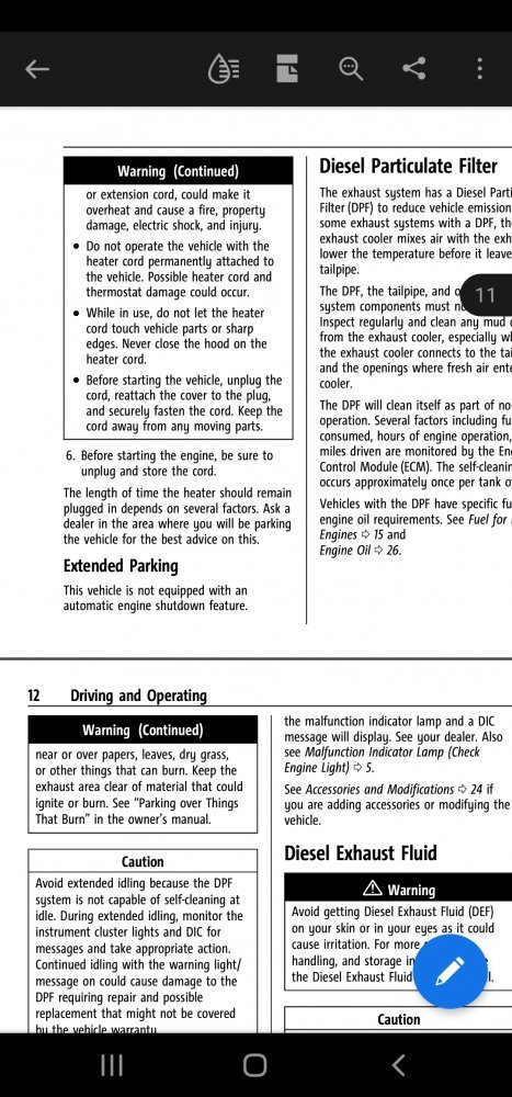

Have any of you LM2 owners left your truck run long enough idling, to have it it shut down? I have heard that the new trucks have some timer that shuts down engine. Like 20 minutes or so.
I have not. I have just read the 3.0 diesel supplement owners manual. There is a 1 line sentence stating the LM2 does not have this timer. I swear I have left it idling for over an hour. Have not timed it, but I will.
If this is true, it is great news for me.

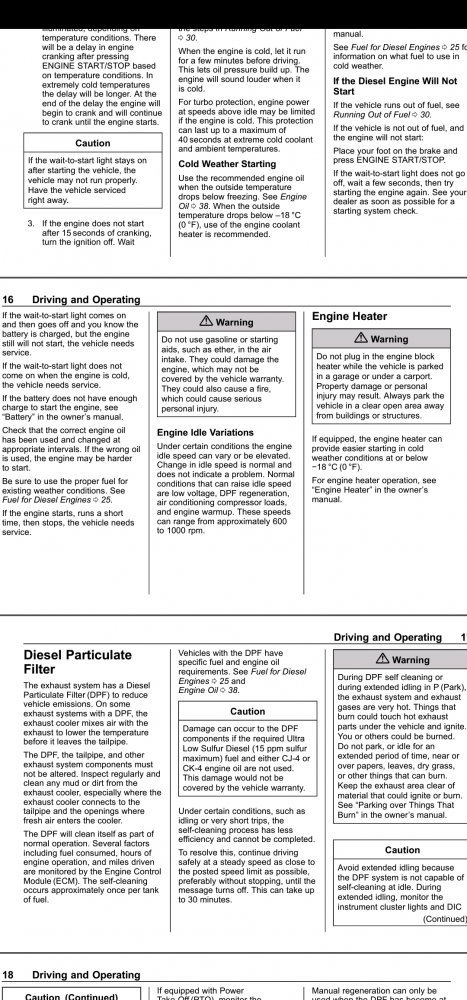

I downloaded the '20s pdf version of the supplement manual, and in the same spot as the '21s version, it is void of that line...

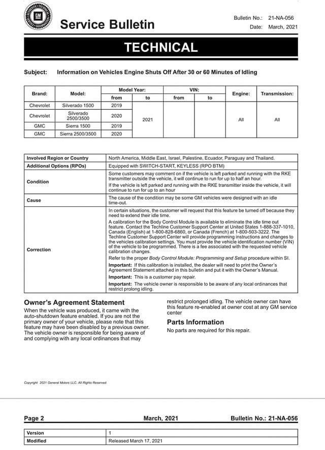

I read somewhere there is a flash the dealer can do to disable the auto shut off.. I need to try and find the TSB#.
