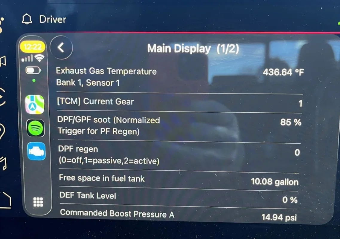

All data is displayed through the factory infotainment system using Apple CarPlay when the phone is connected to the truck.

Issue 1: Dashboard data does not display after connecting​
Cause: Occasionally, when the app connects to the OBDII adapter and you have the “Connect on launch” and “Open dashboard after connecting” selected in the Car Scanner Pro app.The dashboard may load without live data. If you only have the “Connect on launch” selected you will have no issues with the app. This is only with Apple IOS. Android doesn't have this issue.
Fix:
  • Press the back button
  • Re-select the dashboard you want to view
This forces a new data request to the OBDII adapter and refreshes the screen. After doing this once, the app functions normally, and you can freely switch between CarPlay and other infotainment features.

On many GM Duramax trucks, the DEF level PID is inverted, and some scan apps (including Car Scanner Pro) show it backwards.
GM often reports DEF as “DEF % empty” (or “used”) instead of “DEF % remaining.”
So:
0% = tank is FULL
100% = tank is EMPTY
I didn't want to rewrite a custom PID for the app.
I didn't want any Customization.
You could write one if you like.
Create a reversed custom PID​
This makes the app show DEF % remaining instead of % empty.
Steps (Car Scanner Pro)​
  1. Open Car Scanner
  2. Go to Settings
  3. Tap PID Editor
  4. Tap Add custom PID
  5. Enter the following:
    Name:
    DEF Level (Remaining)
    Mode and PID:
    Use the same Mode & PID as the GM DEF level you’re already using
    (you can open the existing one and copy it exactly)
Formula (this is the key part):
100 - A
Min: 0
Max: 100
Unit: %
  1. Save it
  2. Add this new PID to your dashboard
  3. Remove the original DEF PID so you don’t get confused
    Result
  • Full tank → 100%
  • Empty tank → 0%
