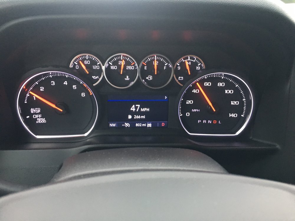

More coffee man, more coffee.mine is way different little blue bars for gas left gauges are a bit more square ....what ...oil pressure!?......never mind.
All looks normal, oil pump is a variable vane pump. Will build pressure when required. Saves fuel not pumping full pressure all the time. Same with the alternator.
