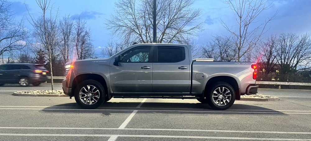

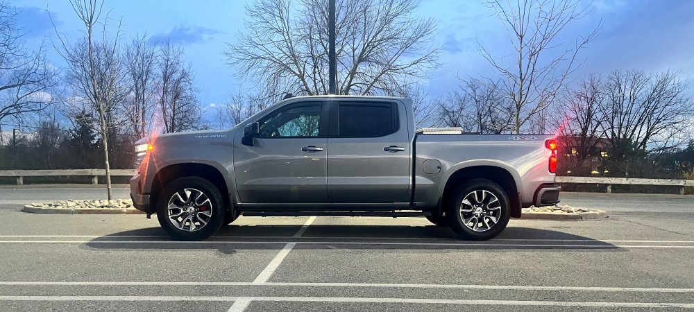

2021 RST, 4x4, crew,3.0L, short bed. factory tire size 275/60/R20, Goodyear Wrangler TrailRunner AT
I installed the top of Strut 2" round spacer(MotorFab) in front of the truck, was a bit front high after this should have done 1.5"
I installed 1" rear kit in rear( Supreme Suspensions ) Blocks and U bolts after the front was actually higher when installed the 2" kit in front
Performed an Alignment and was able to gain all factory specs with adjustments provided, I like all but down the road when Bilstein 5100 s when they become available I will install those in rear, now a bit choppy on corners that have some bumps, but I do run 50psi in tires all around, but if I put 200 pounds in back it feels great
Also Installed iBoard, by APS 5" Wheel to Wheel running boards
