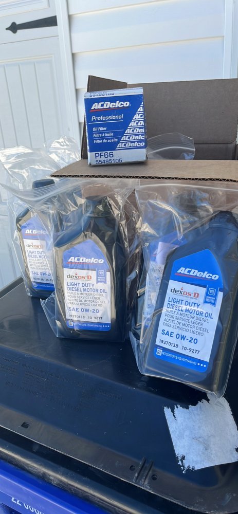

If anyone is interested I have 7 qrts oil and an oil filter. I traded in my 2021 GMC Elevation 3.0 before giving it the oil change so I will give it to anyone that wants it contact me at [email protected]
