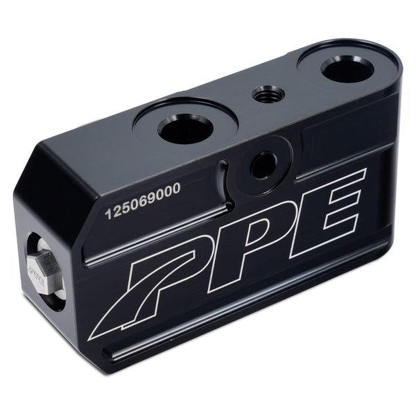

Although I haven't overheated the tranny while towing (maybe saw ~205f max while towing), I'm usually the preventive type. I especially don't like the thermal bypass which doesn't let fluid go to the cooler until it reaches a certain temp. Mine seems to hang around ~195f during normal driving.
Both aren't cheap $351 and $126USD respectively + shipping. PPE ships to Canada for $44 but Demonworks for the cooler doesn't but ships for free to a US address. PPE will ship to a US address for $14.

I have found a slightly cheaper alternative to the PPE cooler bypass block. This kit works with our 10L90E as per their video:
I also like that if there is blockage either in the line or cooler, it will bypass the cooler although the tranny will still overheat.
The stock tranny cooler already looks pretty beefy compared to old radiator and external coolers. If the thermal bypass is disabled and full flow to the cooler is allowed, it should be sufficient.
