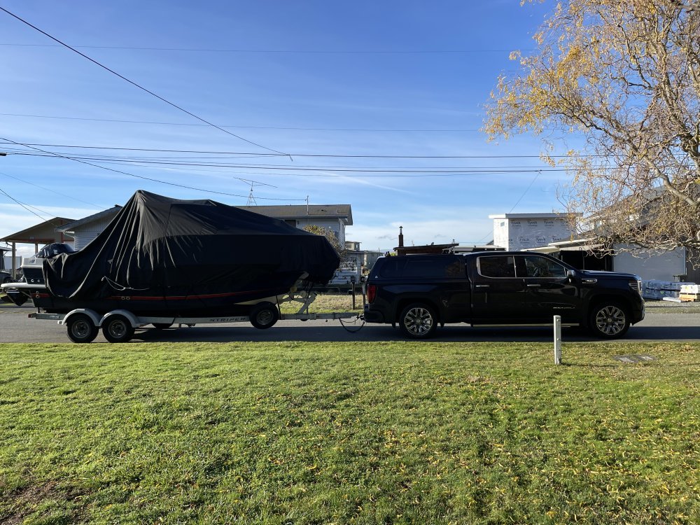

I’ve checked from the dealership, GMC tech-support, local tire and suspension shop and I cannot find an answer on whether or not I could put airbags on the back of the truck for towing purposes. This truck has the ARC suspension system. When I hook up my 6000 pound boat, the truck sags 2 inches in the back.

Am I reading this right? The idea of that is to take the weight off the back of my truck so it won’t sag as much?
Yes the eq hitch will move some of the weight to the front axle. When adjusted correctly you will have only a 1/2 in or so sag. With the weight equally distributed your boat will pull like a dream. No fish tailing, no sag.
