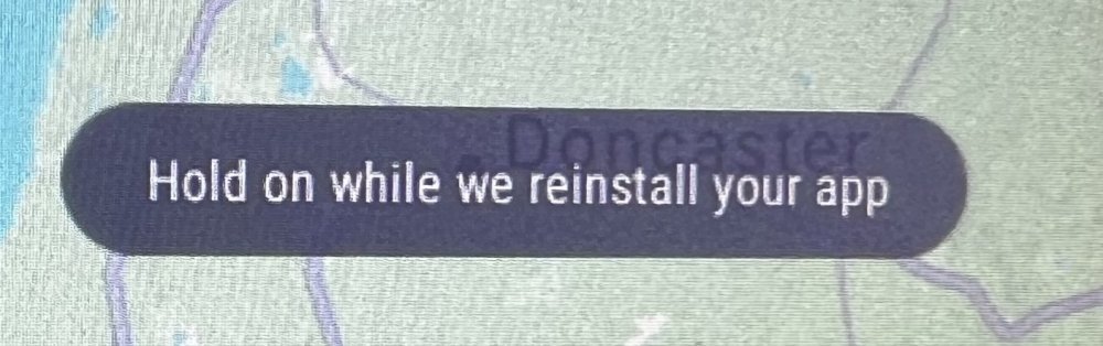

I guess that I did not notice this till recently but I intermittently see a message appear with using apple carplay, but it does not look like a carplay specific pop up though. Anybody seen anything like this?

Looks to be a popup from a Google Service, not Car Play.. but just my guess. I've not noticed that on my fathers 2023 or my wifes 2022. My 2021 doesn't have the new OS/dashboard.
The reason I assumed that message was not carplay is due to the appearance being akin to ota updates on the headunit (the text looks to be in a font that the head unit uses, with that same grey circled background) that I’ve seen in the past and in addition my wife has a hyundai where this message does not appear in carplay from my same phone, and therein lies the conundrum.

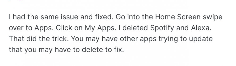

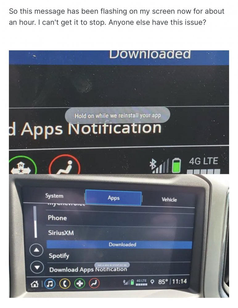

I found someone in another forum that had the same issue, as well as others…..I wonder if there was a fairly recent ota update to the headunit?

Nice find. Let us know if it stop it from happening once you delete those.
