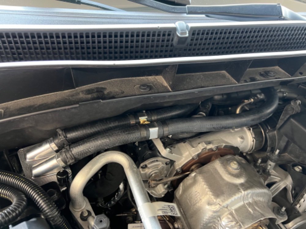

Catch can installed. No easy task but don’t rush it I did buy a pair of clamp pliers which worked well. Everything is a tight fit. I took the two fittings off the catch can which made it easier to install. Hose clamps are a pain but I used the supplied ones.
