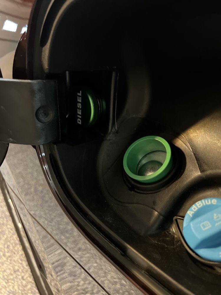

Fuel cap mod
My door cover slid right of with ease but was warm out, really a very easy mod.

The cap sits nicely in the void behind the hinge. Can’t close the door unless you put it back on!

That's a good idea.. I have a habit of sitting mine on the bed rail while I'm filling up. I always look back once I pull off making sure I didn't forget it. :D
