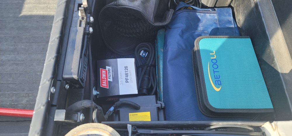

One thing I have learned since the 70's is to make room for treatment and filters in the winter. I keep Hot Shots Secret in the cab and a filter in the crossover toolbox.
