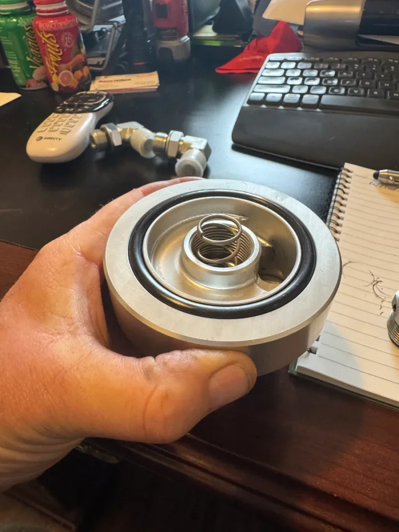

Bought the same set up Rusty has. Ran into problems with the Oil Filter stud having a bypass built into the fitting.
I bought a Hamburgers Adapter with straights and it bottomed out on the fitting for the oil filter. Never could get it to seal to filter housing.
Does anyone know if I can replace the oil filter stud with a different style that does not have the bypass valve built into it?

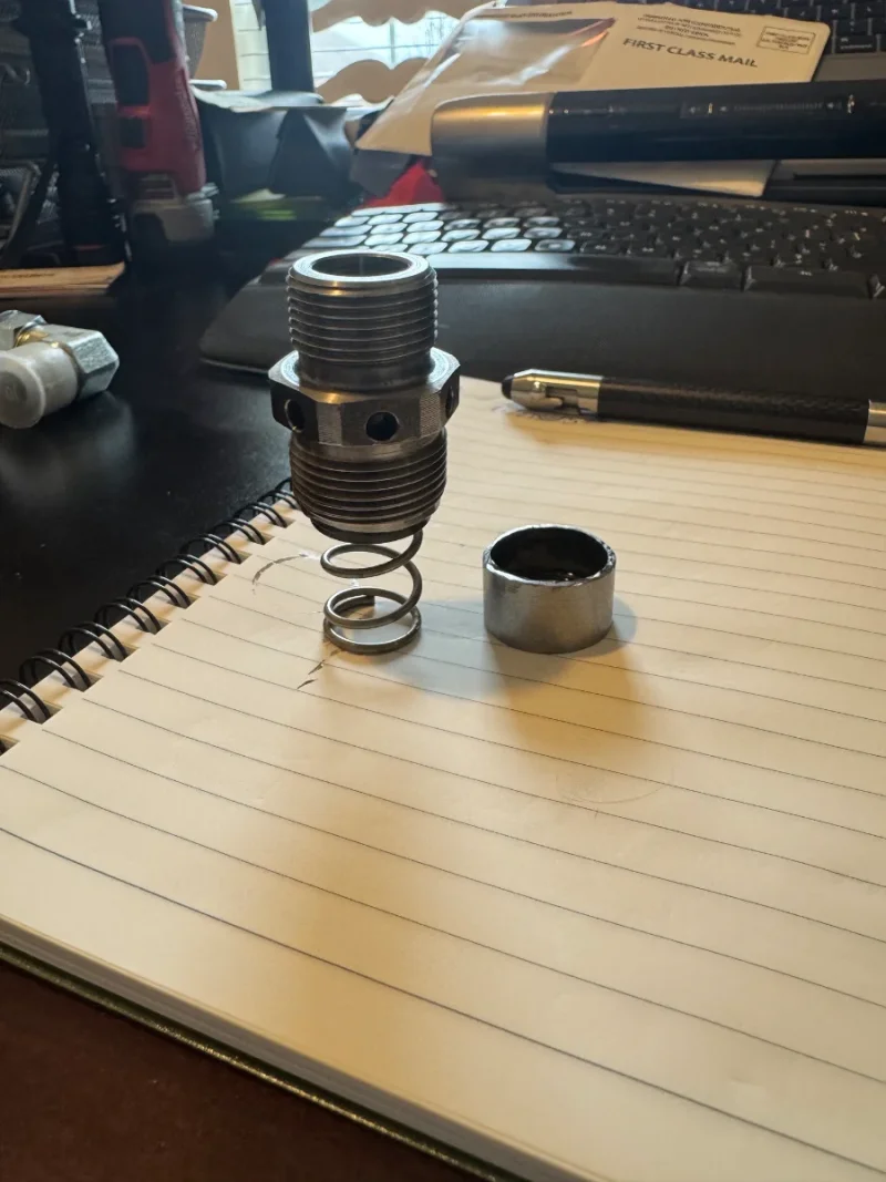

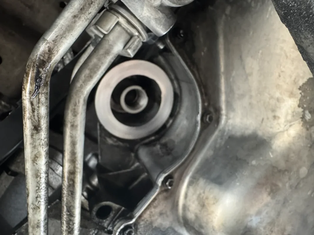

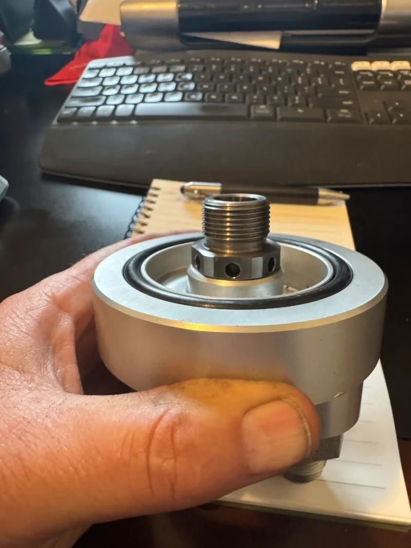

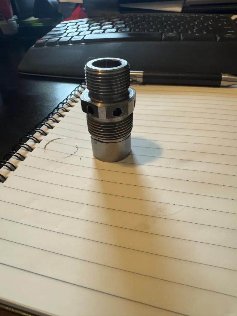

Finally can up with the solution for me to install the Amsoil BK23 oil bypass. Check out pictures. I removed the filter post and dremel cut the extension to allow my Hamburgers Adapter to mount to the post.

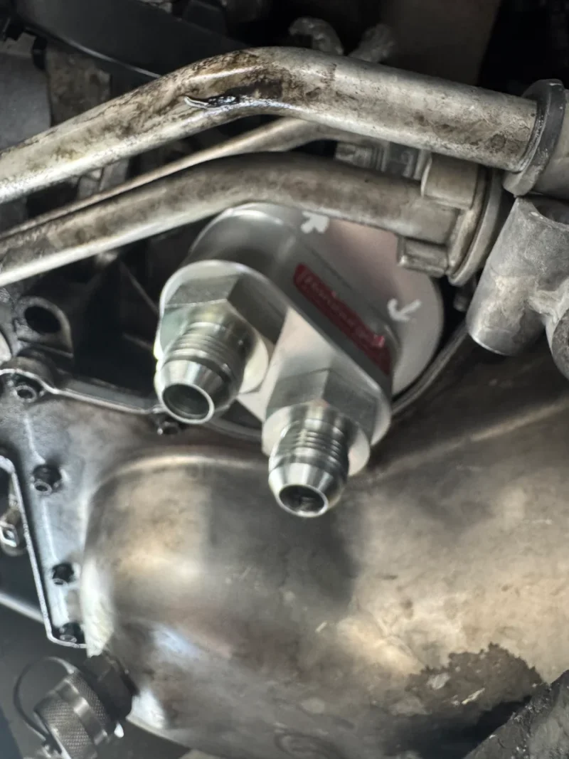

I mounted the Hamburgers Adaptor and hooked up the hoses and good to go! I am Pumped!

Drove in town today but did notice a pressure rise on starting going. Went up to 70lbs then dropped as got going down the road a bit to around 30.
