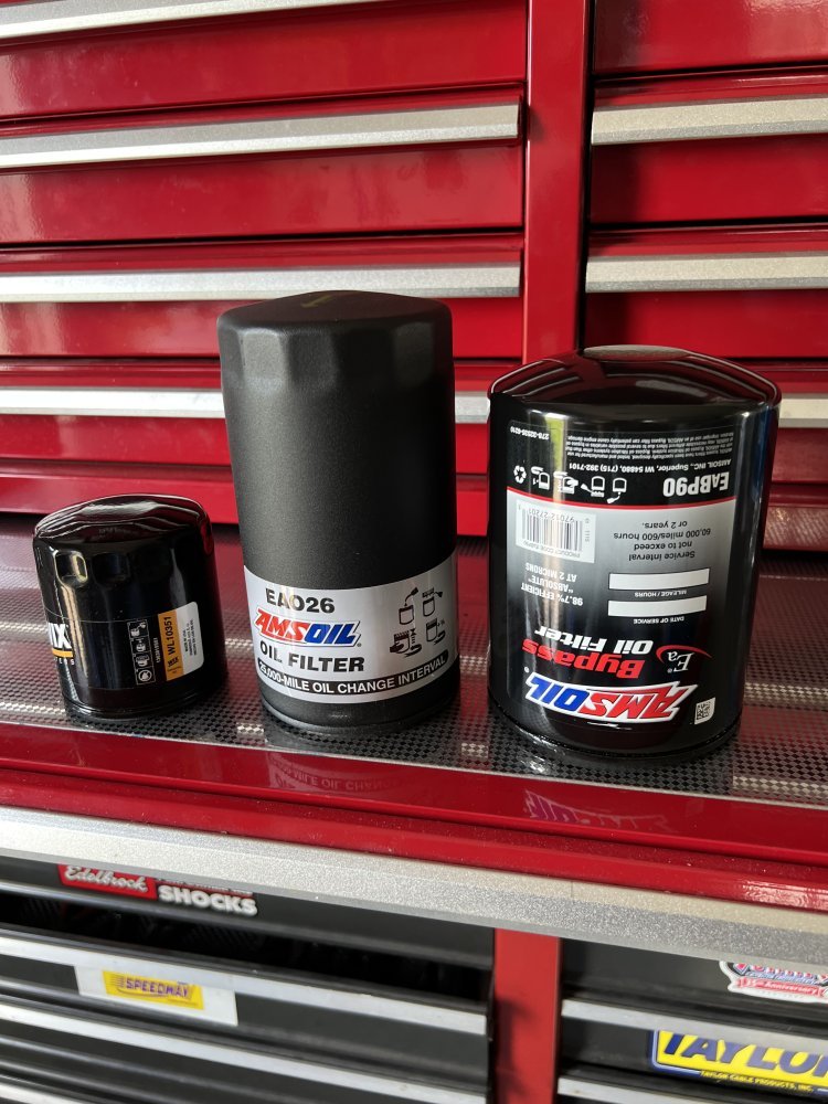

So I went ahead and changed the oil today. I verified that the block mounted adapter fits without issue. Finding a good spot to mount the bypass unit and filters is another story. I’m thinking about mounting it to the outside of the driver’s side frame rail. Looks like there is good clearance for running the hoses. Thinking it would be a good idea to fabricate a shield around it.Here’s a picture of the full flow and the bypass filter next to the wix filter for our 3.0L. The bypass filter will take the soot out of your oil. I’m waiting to do my first oil change to verify the filter adapter fits without issue before I report the remaining part numbers. I’m only at 995 miles so possibly at 2000 so I can switch to the Amsoil Dexos D.
No. That will be the full flow filter on the bypass mount.The EAO26 filter in your pic, are you using that the replace the small stock GM PF66 filter?
